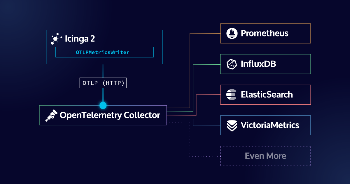

Then configure the OTLPMetricsWriter object in /etc/icinga2/features-enabled/otlpmetrics.conf. Here’s a minimal example that sends metrics to a local OpenTelemetry Collector:
object OTLPMetricsWriter "otlp-metrics" {
  host = "otel-collector"
  port = 4318
If you want to send metrics directly to a backend that supports OTLP ingestion natively (like Prometheus or Grafana Mimir), you can point the writer at that endpoint instead:
object OTLPMetricsWriter "prometheus" {
  host = "prometheus"
  port = 9090
  metrics_endpoint = "/api/v1/otlp/v1/metrics"
object OTLPMetricsWriter "mimir" {
  host = "mimir"
  port = 8080
  metrics_endpoint = "/otlp/v1/metrics"
You can define multiple OTLPMetricsWriter objects to send metrics to several destinations simultaneously. Each writer maintains its own connection and operates independently. Want thresholds included as separate metrics? Enable them:
object OTLPMetricsWriter "otel" {
  port = 4318
  enable_send_thresholds = true

The OpenTelemetry Collector as a Hub
For maximum flexibility, route your metrics through the OpenTelemetry Collector. The Collector acts as a processing pipeline where you can filter, transform, batch, and fan out metrics to multiple destinations simultaneously. Want the same Icinga metrics in Prometheus for dashboarding AND in Elastic for correlation with logs? The Collector makes that a single config change.
