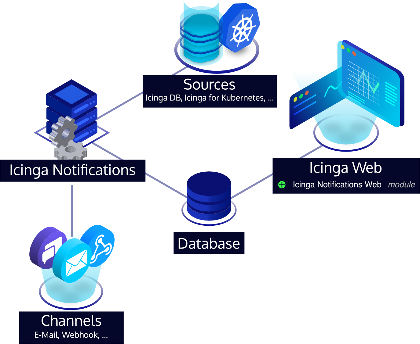

What Is Icinga Notifications, Anyway?
Before we dive in, a quick primer. Icinga Notifications is a dedicated component that sits alongside your existing Icinga 2 setup and takes over the entire notification lifecycle. Rather than relying on Icinga 2’s built-in (and somewhat limited) notification system, Icinga Notifications receives state change events from your monitored infrastructure, decides whether to open an incident, and then routes alerts to the right people through the right channels: email, Rocket.Chat, webhooks, and more.
The web frontend, Icinga Notifications Web, is where all the configuration lives: contacts, contact groups, escalation rules, schedules, and channel setup. Critically for us, it also exposes a REST API that lets you manage contacts and contact groups programmatically, which is exactly the hook we need to keep things in sync with LDAP.
