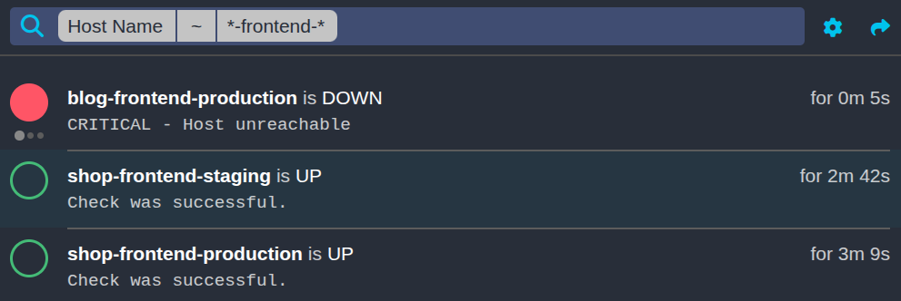

Wildcards with Like and Unlike
The like (~) and unlike (!~) operators allow you to use * as a wildcard. host.name~web* matches every host whose name starts with web, while host.name!~web* matches every host whose name doesn’t. A wildcard can go at any position in the value, and you can use as many as you need: host.name~*-frontend-* matches every frontend, no matter which app or environment, but not shop-database-production.
Wildcards only work with ~ and !~: host.name=web* looks for a host that is literally named web*.
Icinga Web filter with a wildcard in the host list

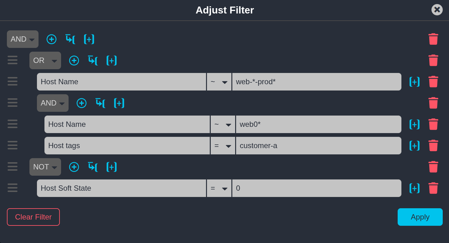

Search Bar vs. Search Editor
The search bar is the quickest way to type a filter, but once you nest groups inside groups, it gets hard to keep track of which parenthesis closes what. That’s what the search editor is for: click the filter icon next to the search bar, and it shows the same filter as a tree. You can add, remove, and negate conditions and groups there, and switch between & and | for each group, without counting parentheses.
Nested Icinga Web filter in the search editor
Both edit the same filter, so you can start in the search bar and switch to the editor whenever it gets complicated, or the other way around.
