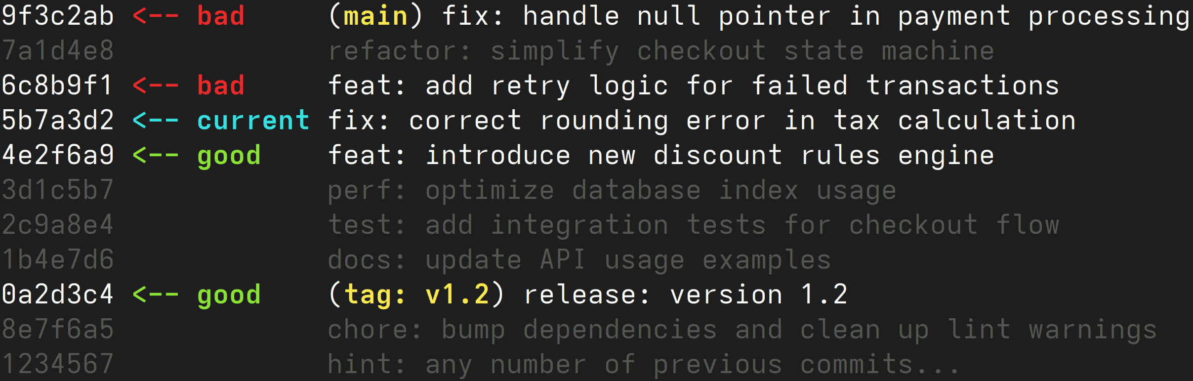

The visualizations in this article were generated using a small helper script I wrote. It displays a color-coded view of commits during a git bisect session, highlighting the current commit as well as commits marked as good, bad, or skipped. After performing the steps described above, the commit history looks like this:

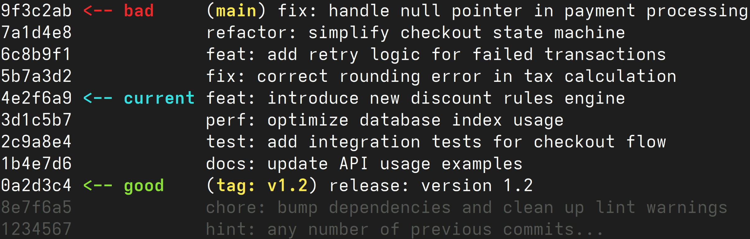

Git automatically checks out a commit that best divides the list in half, in this case 4e2f6a9.
All we have to do is test if the current commit contains the bug or not.

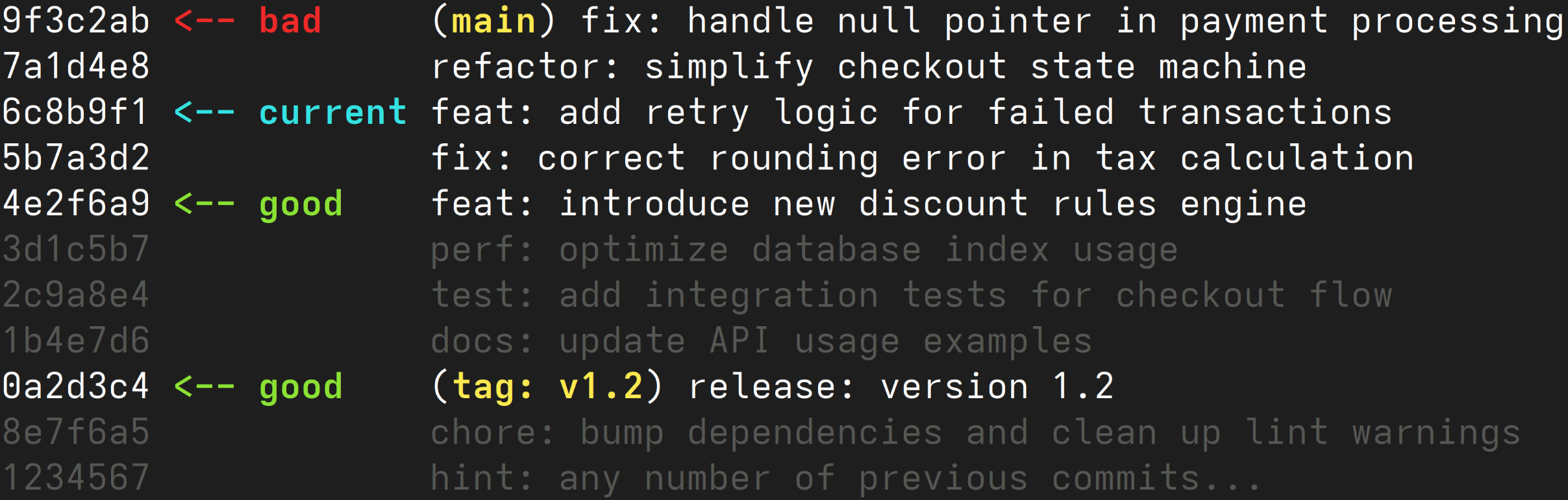

We determine that it doesn’t, so we type git bisect good.
All commits before this one don’t need to be checked, since it can’t contain the bug in question.
Git now does everything for us and the history looks like this.
The next commit is automatically checked out and we have to test again.

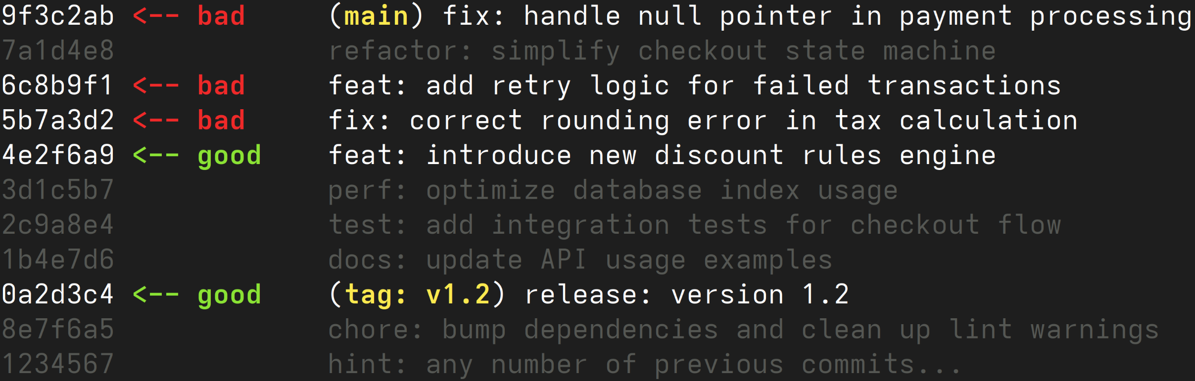

This time it contains the bug, so we type git bisect bad.
Now there is only one commit left. Git will ask us to test this one as well, in this case it’s a good commit.
Git has now determined that 5b7a3d2 is the commit that broke the application and automatically sets refs/bisect/bad to point at it.
The following output is displayed in the terminal:
5b7a3d23740ec6921614283a0989fe5040023ecd is the first bad commit
