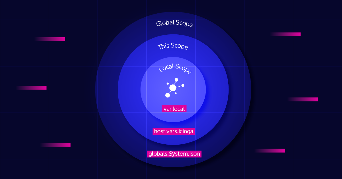

Variable Scopes
Icinga 2 has three different variable scopes: global, this, and local. Each scope has its own rules for defining and accessing variables, and you can think of them as series of stacked boxes, with each box having its own set of variables. The global scope is the most permissive, and allows you to access variables from anywhere in the configuration. The this scope is more restrictive, and you can access variables only within the context of the current object. Finally, the local scope is the most restrictive, allowing access to variables only within the block or function where they are defined. Let’s take a closer look at each of these scopes and how they work in practice.
Global Scope
The global scope is the highest level of variable scope in Icinga 2. Variables defined in the global scope are accessible from anywhere (is equivalent to Go’s universe scope). There’s exactly one global scope in Icinga 2, and is typically used for constants or settings that need to be shared across the entire configuration. To define a global variable, you can use the globals keyword explicitly, like this:

The this Scope
The this scope is a special variable scope that refers to the current object or context in which the code is being evaluated. If you’re familiar with object-oriented programming, you can think of this as the equivalent of self in Python or this in JavaScript. It allows you to access properties and methods (if any) of the current object. In Icinga 2, the this scope usually refers to some object/apply context, such as a host or service object. When you set a variable with the this scope, you must also make sure that the variable you’re trying to access is allowed in that context. For instance, if you try to set some variable in an object Host ... context, you can only access variables that are defined in the Host object, such as name, address, etc., otherwise you will get an error like this:

Local Scope
The local scope is the most restrictive variable scope in Icinga 2. They are typically used for temporary values or intermediate calculations that do not need to be shared outside their context. To define a local variable, you can either use the locals or var keyword, like this anywhere in your config file:

Variable Resolution in Icinga 2
When Icinga 2 evaluates an expression, it follows a specific order to resolve variables based on their scopes. The order of resolution is as follows:
  1. Local Scope: Icinga 2 first checks the local scope for the variable. If it finds a variable with the same name, it uses that value and stops searching further.
  2. This Scope: If the variable is not found in the local scope, Icinga 2 checks the this scope. If it finds a variable with the same name in the this scope, it aborts the lookup and uses the value of that variable.
  3. Global Scope: Only if the variable is not found in either the local or this scope, Icinga 2 checks the global scope. If it finds a variable with the same name in the global scope, then it uses that value and is done searching.
You see, Icinga 2 resolves variables in a hierarchical manner, starting from the local scope and moving up to the global scope. That’s why you should be careful when defining variables with the same name in different scopes, as it can lead to unexpected behavior and confusion. For instance, if you’ve a configuration like this:
