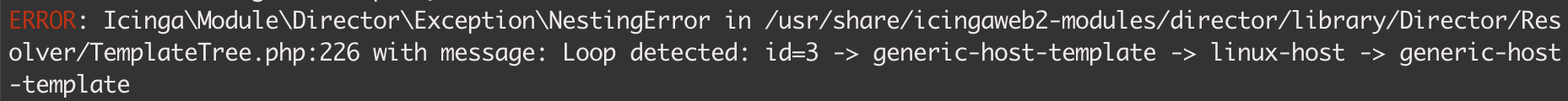

Occasionally, though, you may unintentionally introduce a cyclic inheritance while configuring templates.
A typical case occurs when a template imports another template that eventually imports the original one again. For example, if template A imports template B, and B imports A, this creates a loop that Icinga Director cannot resolve. When this happens, Director correctly detects the problem and reports a “Loop detected” error as shown in the example below.

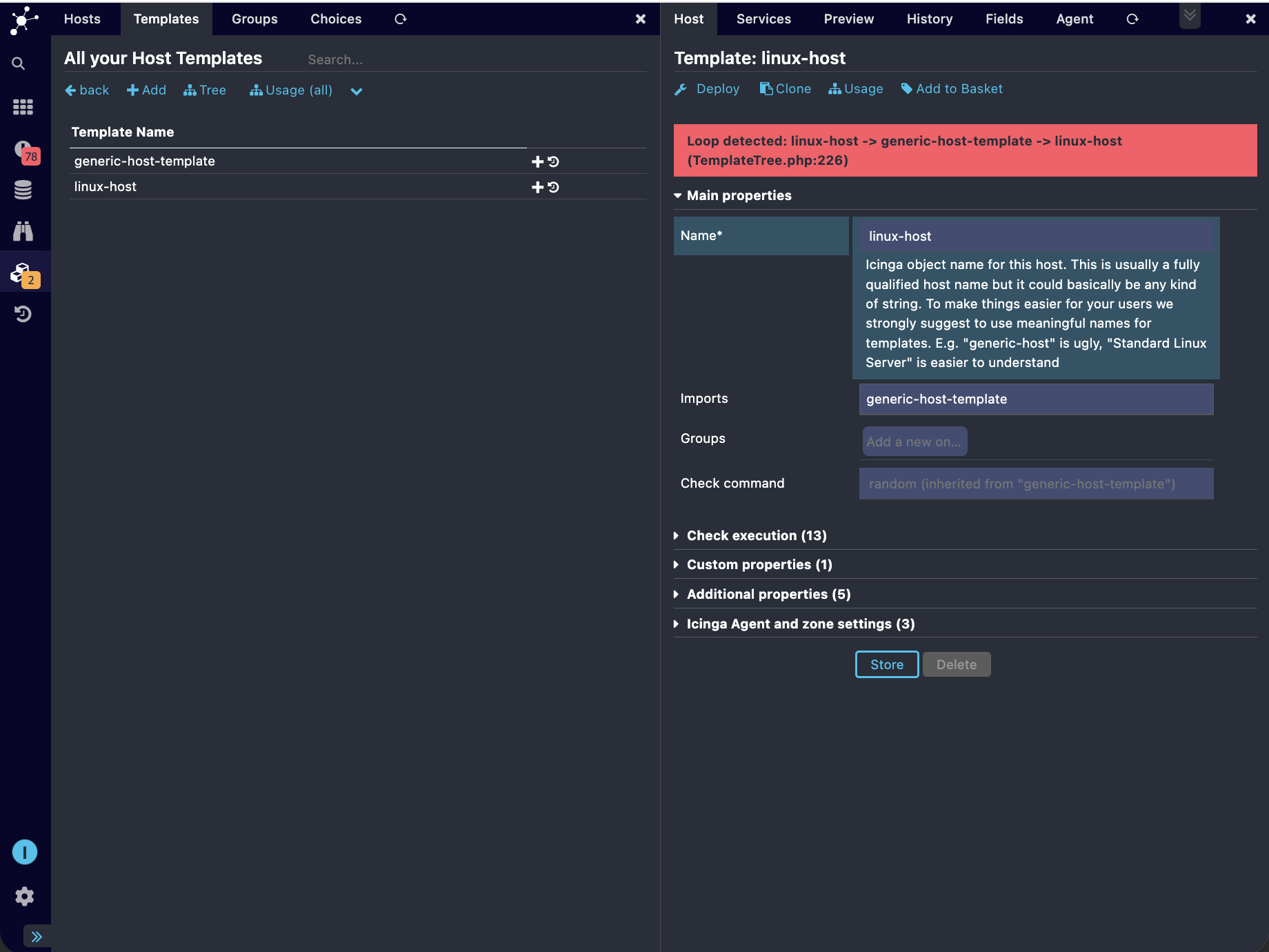

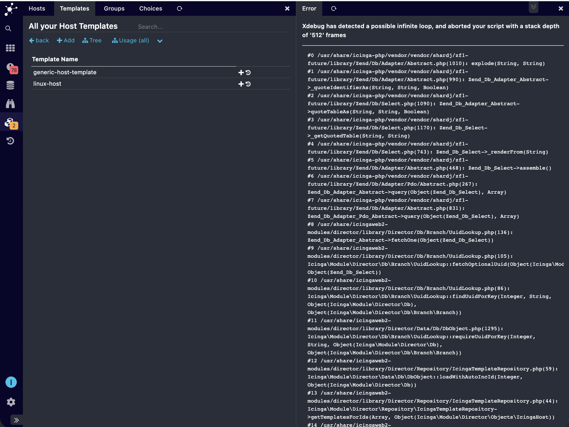

Unfortunately, once such a cycle exists, the object configuration page for the affected template may no longer load correctly, and modifying that template—and any objects that depend on it—becomes impossible through the UI.
The good news is: there’s no need to panic. There are a few simple ways to resolve this situation.
I’ll walk through the process using an example: a cyclic inheritance created between the host templates linux-host → generic-host-template → linux-host. The above screenshots already shows the error caused because of this configuration.

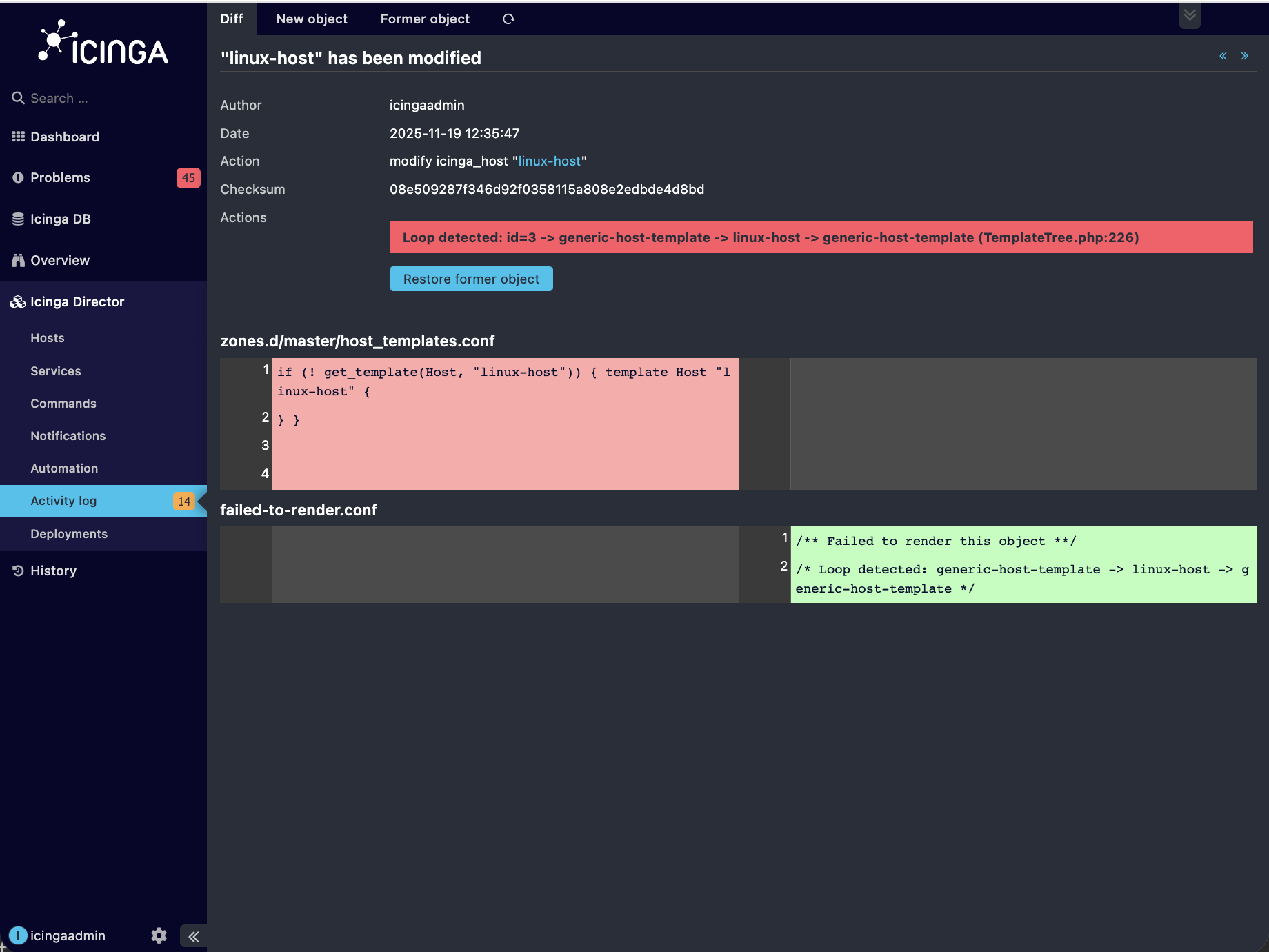

1. Undo the Change Using the Activity Log
The first method is to simply undo the changes in the Activity Log.

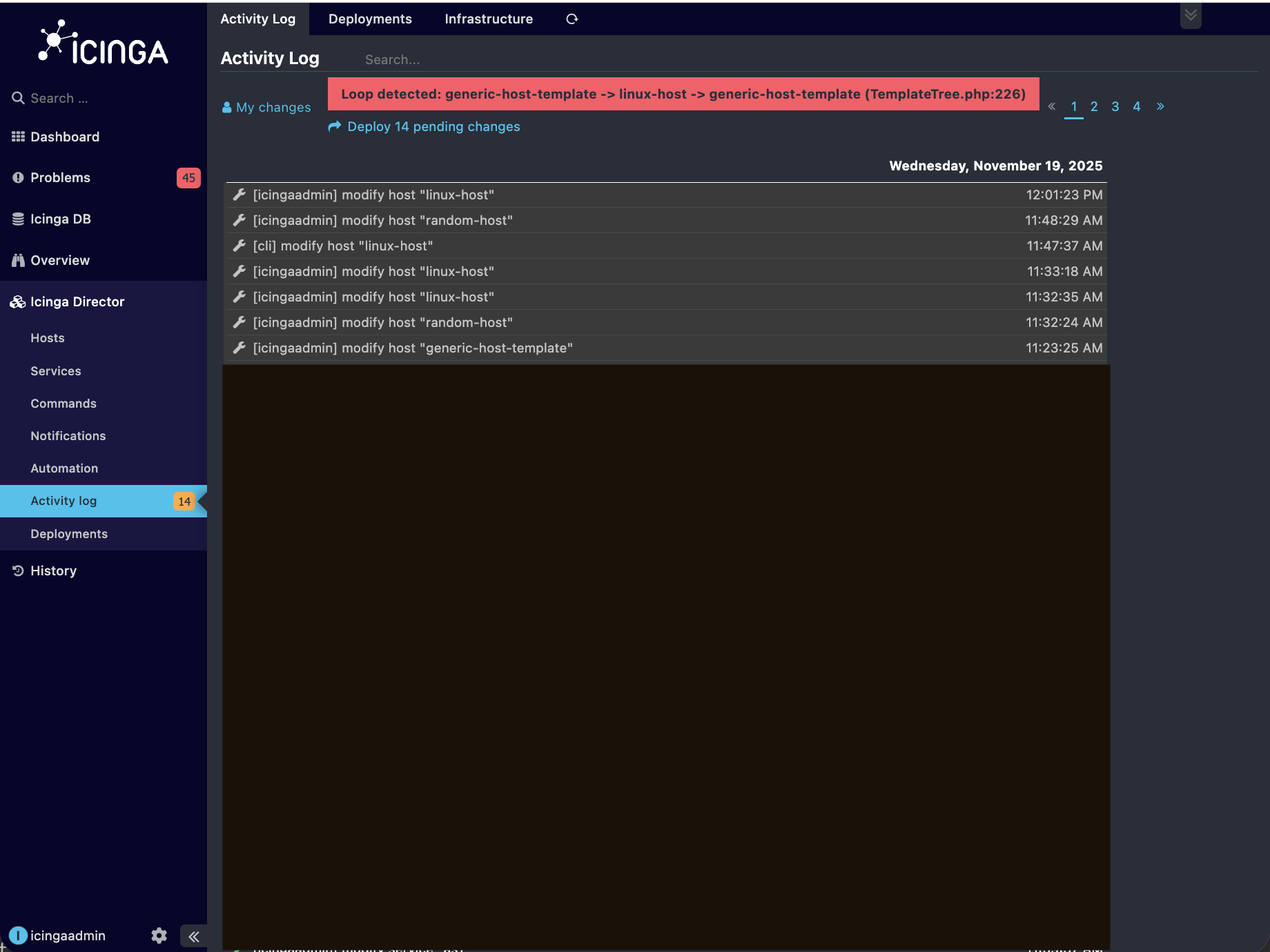

  • Navigate to Icinga Director -> Activity Log

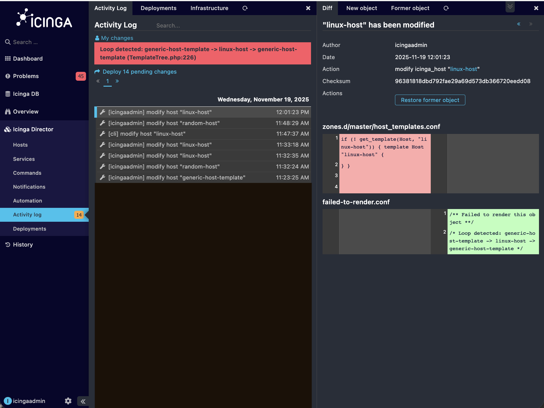

  • Locate the activity entry that created the cyclic inheritance.
  • Open it and click on Restore former Object in the Diff page. Despite the warning message that may appear, the previous configuration will be restored successfully. You can verify this by navigating back to the affected object.
This returns the template to its earlier, valid configuration.
The downside is that all changes included in that activity log entry will be reverted, not just the cyclic import. If you want to remove only the specific problematic import, the next method is preferable.
