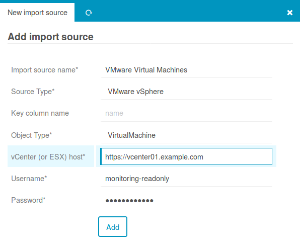

At the time of this writing, the main purpose of this module is being a Import Source provider for the Icinga Director:
Import from VMware vSphere
