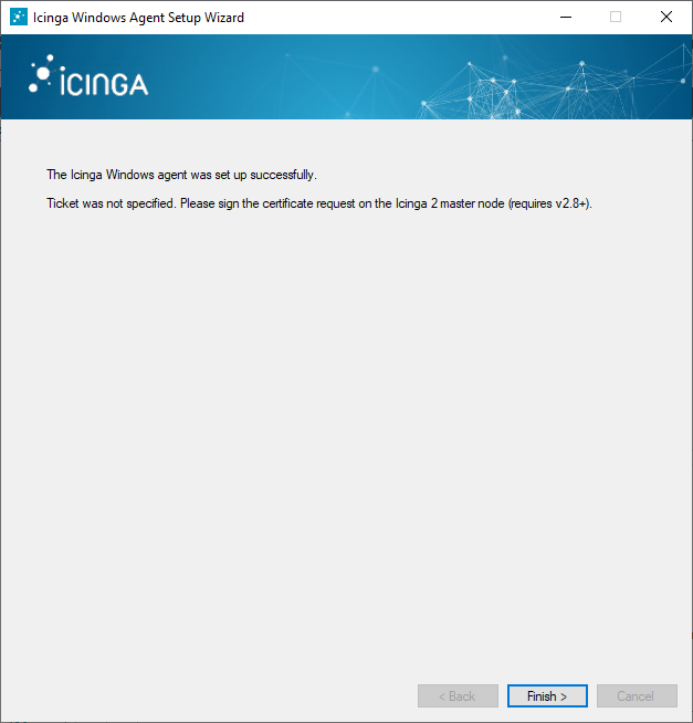

Proceed with adding the optional client ticket for CSR auto-signing:
Please specify the request ticket generated on your Icinga 2 master (optional).
 (Hint: # icinga2 pki ticket --cn 'icinga2-agent1.localdomain'):
4f75d2ecd253575fe9180938ebff7cbca262f96e
In case you’ve chosen to use On-Demand CSR Signing you can leave the ticket question blank.
Instead, Icinga 2 tells you to approve the request later on the master node.
No ticket was specified. Please approve the certificate signing request manually
on the master (see 'icinga2 ca list' and 'icinga2 ca sign --help' for details).

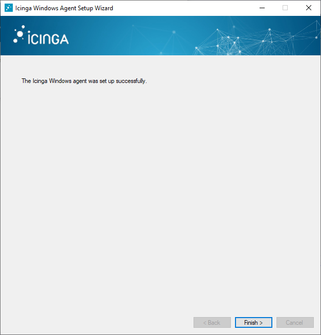

Run the MSI-Installer package and follow the instructions shown in the screenshots.
Icinga 2 Windows Setup Icinga 2 Windows Setup Icinga 2 Windows Setup Icinga 2 Windows Setup Icinga 2 Windows Setup
The graphical installer offers to run the Icinga Agent setup wizard after the installation. Select the check box to proceed.
Tip
You can also run the Icinga agent setup wizard from the Start menu later.
Agent Setup on Windows: Configuration Wizard
On a fresh installation the setup wizard guides you through the initial configuration. It also provides a mechanism to send a certificate request to the CSR signing master.

Setup ticket Optional. Paste the previously generated ticket number. If left blank, the certificate request must be signed on the master node.

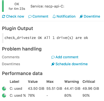

Open a web browser and navigate to https://localhost:8443. Enter the password you’ve configured during the setup. In case you lost it, look into the C:\Program Files\NSClient++\nsclient.ini configuration file.
Icinga 2 Windows Setup NSClient++
The NSClient++ REST API can be used to query metrics. check_nscp_api uses this transport method.
Finish Windows Agent Setup
Finish the Windows setup wizard.
If you did not provide a setup ticket, you need to sign the certificate request on the master. The setup wizards tells you to do so. The Icinga 2 service is running at this point already and will automatically receive and update a signed client certificate.

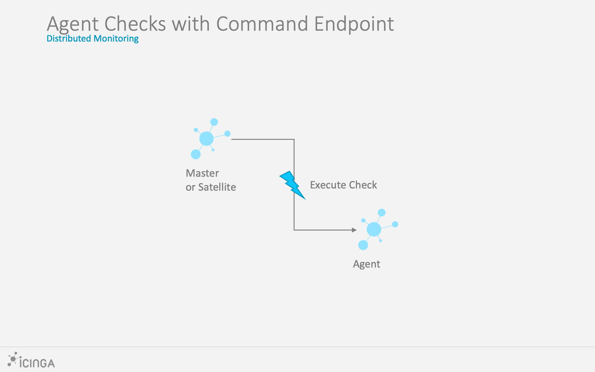

Top Down Command Endpoint
This mode forces the Icinga 2 node to execute commands remotely on a specified endpoint. The host/service object configuration is located on the master/satellite and the agent only needs the CheckCommand object definitions available.
Every endpoint has its own remote check queue. The amount of checks executed simultaneously can be limited on the endpoint with the MaxConcurrentChecks constant defined in constants.conf. Icinga 2 may discard check requests, if the remote check queue is full.
Icinga 2 Distributed Top Down Command Endpoint

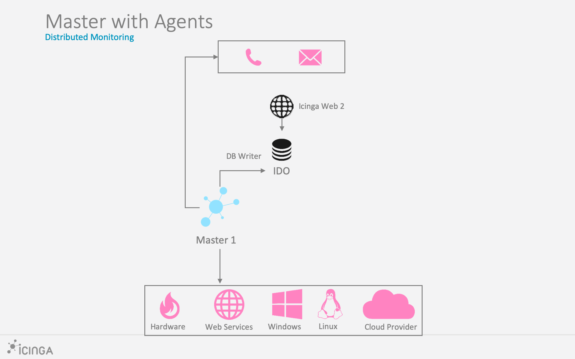

Master with Agents
In this scenario, a single master node runs the check scheduler, notifications and IDO database backend and uses the command endpoint mode to execute checks on the remote agents.
Icinga 2 Distributed Master with Agents
  • icinga2-master1.localdomain is the primary master node.
  • icinga2-agent1.localdomain and icinga2-agent2.localdomain are two child nodes as agents.

[root@icinga2-master1.localdomain /]# vim /etc/icinga2/zones.conf
object Endpoint "icinga2-master1.localdomain" {
  // That's us
object Endpoint "icinga2-agent1.localdomain" {
  host = "192.168.56.111" // The master actively tries to connect to the agent
  log_duration = 0 // Disable the replay log for command endpoint agents
object Endpoint "icinga2-agent2.localdomain" {
  host = "192.168.56.112" // The master actively tries to connect to the agent
object Zone "master" {
  endpoints = [ "icinga2-master1.localdomain" ]
object Zone "icinga2-agent1.localdomain" {
  endpoints = [ "icinga2-agent1.localdomain" ]
  parent = "master"
object Zone "icinga2-agent2.localdomain" {
  endpoints = [ "icinga2-agent2.localdomain" ]
  parent = "master"
/* sync global commands */
  global = true
  global = true

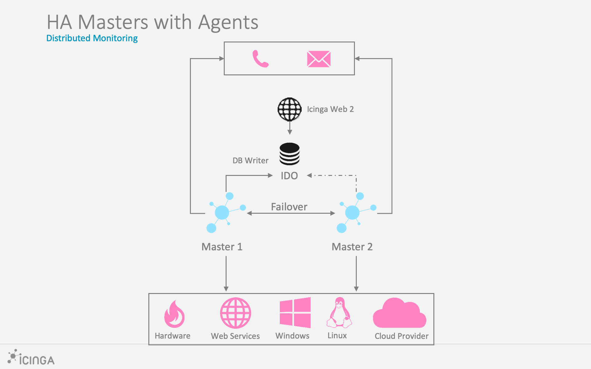

High-Availability Master with Agents
This scenario is similar to the one in the previous section. The only difference is that we will now set up two master nodes in a high-availability setup. These nodes must be configured as zone and endpoints objects.
Icinga 2 Distributed High Availability Master with Agents
The setup uses the capabilities of the Icinga 2 cluster. All zone members replicate cluster events between each other. In addition to that, several Icinga 2 features can enable HA functionality.
Best practice is to run the database backend on a dedicated server/cluster and only expose a virtual IP address to Icinga and the IDO feature. By default, only one endpoint will actively write to the backend then. Typical setups for MySQL clusters involve Master-Master-Replication (Master-Slave-Replication in both directions) or Galera, more tips can be found on our community forums. The IDO object must have the same instance_name on all master nodes.
Note: All nodes in the same zone require that you enable the same features for high-availability (HA).

Pin Checks in a Zone
In case you want to pin specific checks to their endpoints in a given zone you’ll need to use the command_endpoint attribute. This is reasonable if you want to execute a local disk check in the master Zone on a specific endpoint then.
[root@icinga2-master1.localdomain /]# mkdir -p /etc/icinga2/zones.d/master
[root@icinga2-master1.localdomain /]# vim /etc/icinga2/zones.d/master/icinga2-master1.localdomain.conf
object Host "icinga2-master1.localdomain" {
  check_command = "hostalive"
  address = "192.168.56.101"
[root@icinga2-master1.localdomain /]# vim /etc/icinga2/zones.d/master/services.conf
apply Service "disk" {
  check_command = "disk"
  command_endpoint = host.name //requires a host object matching the endpoint object name e.g. icinga2-master1.localdomain
  assign where host.zone == "master" && match("icinga2-master*", host.name)
The host.zone attribute check inside the expression ensures that the service object is only created for host objects inside the master zone. In addition to that the match function ensures to only create services for the master nodes.

Based on the master with agents scenario we’ll now add a local disk check.
First, add the agent node as host object:
[root@icinga2-master1.localdomain /]# cd /etc/icinga2/zones.d/master
[root@icinga2-master1.localdomain /etc/icinga2/zones.d/master]# vim hosts.conf
object Host "icinga2-agent2.localdomain" {
  address = "192.168.56.112"
  vars.agent_endpoint = name //follows the convention that host name == endpoint name
  vars.os_type = "windows"
Next, add the disk check using command endpoint checks (details in the disk-windows documentation):
[root@icinga2-master1.localdomain /etc/icinga2/zones.d/master]# vim services.conf
apply Service "disk C:" {
  check_command = "disk-windows"
  vars.disk_win_path = "C:"
  //specify where the check is executed
  command_endpoint = host.vars.agent_endpoint
  assign where host.vars.os_type == "windows" && host.vars.agent_endpoint
Validate the configuration and restart Icinga 2.
[root@icinga2-master1.localdomain /]# icinga2 daemon -C
[root@icinga2-master1.localdomain /]# systemctl restart icinga2
Open Icinga Web 2 and check your newly added Windows disk check :)

Two new services (“nscp-drive-D:” and “nscp-drive-C:”) will be visible in Icinga Web 2.
Icinga 2 Distributed Monitoring Windows Agent with NSClient++ nscp-api
Note: You can also omit the command_endpoint configuration to execute the command on the master. This also requires a different value for nscp_api_host which defaults to host.address.
  //command_endpoint = host.vars.agent_endpoint
  //vars.nscp_api_host = "localhost"
You can verify the check execution by looking at the Check Source attribute in Icinga Web 2 or the REST API.

High-Availability for Icinga 2 Features
By default, the following features provide advanced HA functionality:
High-Availability with Checks
All instances within the same zone (e.g. the master zone as HA cluster) must have the checker feature enabled.
Example:
# icinga2 feature enable checker
All nodes in the same zone load-balance the check execution. If one instance shuts down, the other nodes will automatically take over the remaining checks.
High-Availability with Notifications
All instances within the same zone (e.g. the master zone as HA cluster) must have the notification feature enabled.
Example:
# icinga2 feature enable notification
Notifications are load-balanced amongst all nodes in a zone. By default this functionality is enabled. If your nodes should send out notifications independently from any other nodes (this will cause duplicated notifications if not properly handled!), you can set enable_ha = false in the NotificationComponent feature.
High-Availability with DB IDO
All instances within the same zone (e.g. the master zone as HA cluster) must have the DB IDO feature enabled.
Example DB IDO MySQL:
# icinga2 feature enable ido-mysql
By default the DB IDO feature only runs on one node. All other nodes in the same zone disable the active IDO database connection at runtime. The node with the active DB IDO connection is not necessarily the zone master.
Note: The DB IDO HA feature can be disabled by setting the enable_ha attribute to false for the IdoMysqlConnection or IdoPgsqlConnection object on all nodes in the same zone.
All endpoints will enable the DB IDO feature and connect to the configured database and dump configuration, status and historical data on their own.
If the instance with the active DB IDO connection dies, the HA functionality will automatically elect a new DB IDO master.
The DB IDO feature will try to determine which cluster endpoint is currently writing to the database and bail out if another endpoint is active. You can manually verify that by running the following query command:
icinga=> SELECT status_update_time, endpoint_name FROM icinga_programstatus;

Silent Windows Setup
If you want to install the agent silently/unattended, use the /qn modifier. The installation should not trigger a restart, but if you want to be completely sure, you can use the /norestart modifier.
C:> msiexec /i C:\Icinga2-v2.5.0-x86.msi /qn /norestart
Once the setup is completed you can use the node setup cli command too.

In case you did not provide a ticket, you need to manually sign the CSR on the master node which holds the CA’s key pair.
