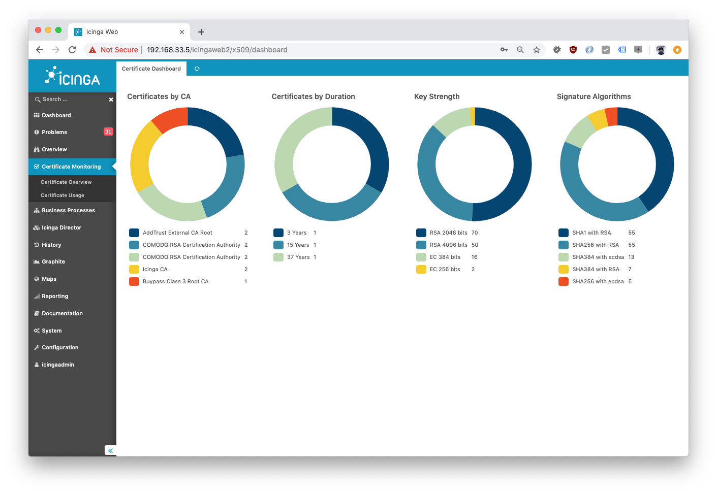

Certificate Monitoring ¶
Monitor your certificates in an efficient and comfortable way. Be aware of required actions and view all details at a glance.
