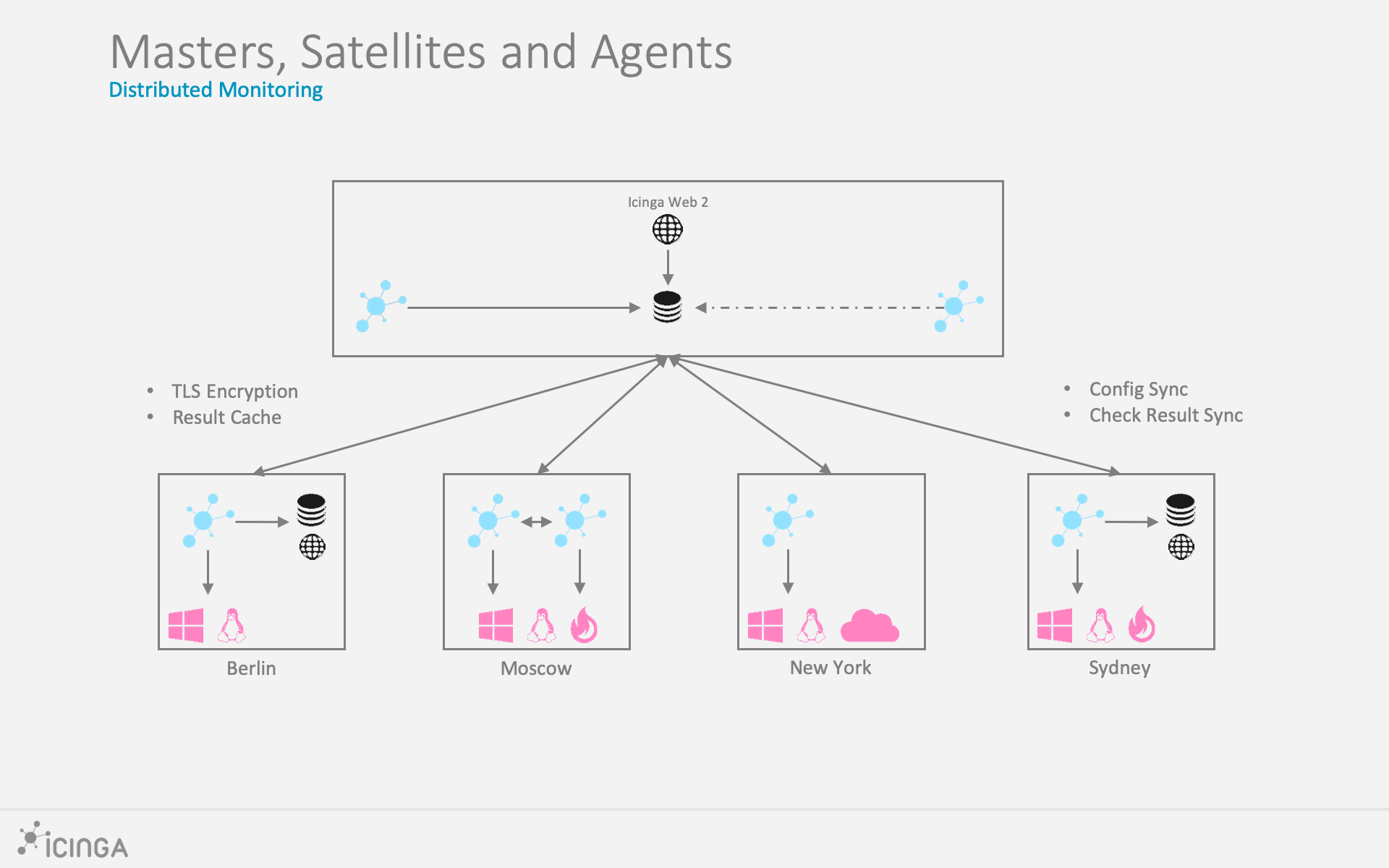

Roles: Master, Satellites and Agents
Icinga 2 nodes can be given names for easier understanding:
  • A master node which is on top of the hierarchy.
  • A satellite node which is a child of a satellite or master node.
  • An agent node which is connected to master and/or satellite nodes.

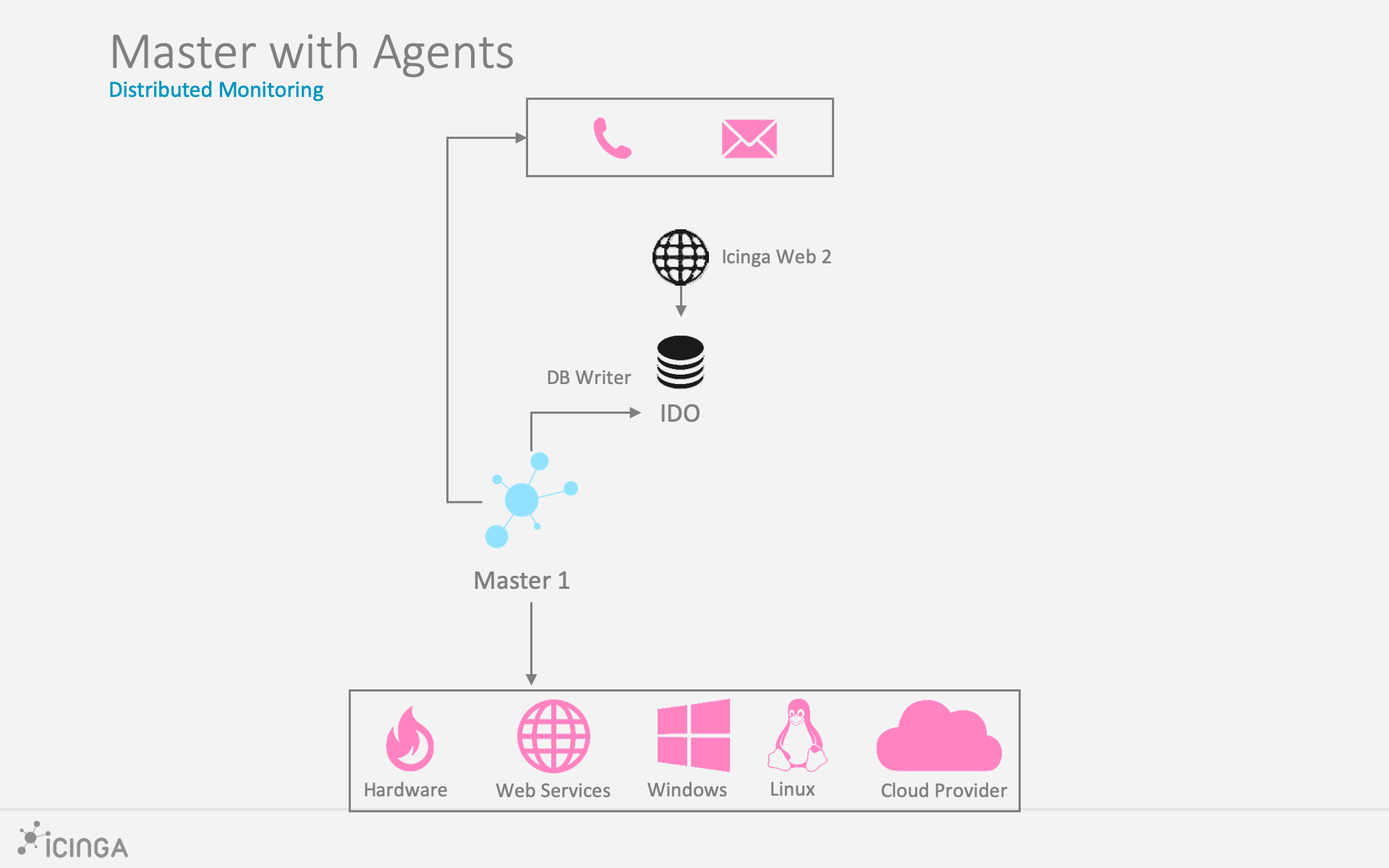

Icinga 2 Distributed Roles
Rephrasing this picture into more details:
  • A master node has no parent node.
    • A masternode is where you usually install Icinga Web 2.
    • A master node can combine executed checks from child nodes into backends and notifications.
  • A satellite node has a parent and a child node.
    • A satellite node may execute checks on its own or delegate check execution to child nodes.
    • A satellite node can receive configuration for hosts/services, etc. from the parent node.
    • A satellite node continues to run even if the master node is temporarily unavailable.
  • An agent node only has a parent node.
    • An agent node will either run its own configured checks or receive command execution events from the parent node.
A client can be a secondary master, a satellite or an agent. It typically requests something from the primary master or parent node.
The following sections will refer to these roles and explain the differences and the possibilities this kind of setup offers.

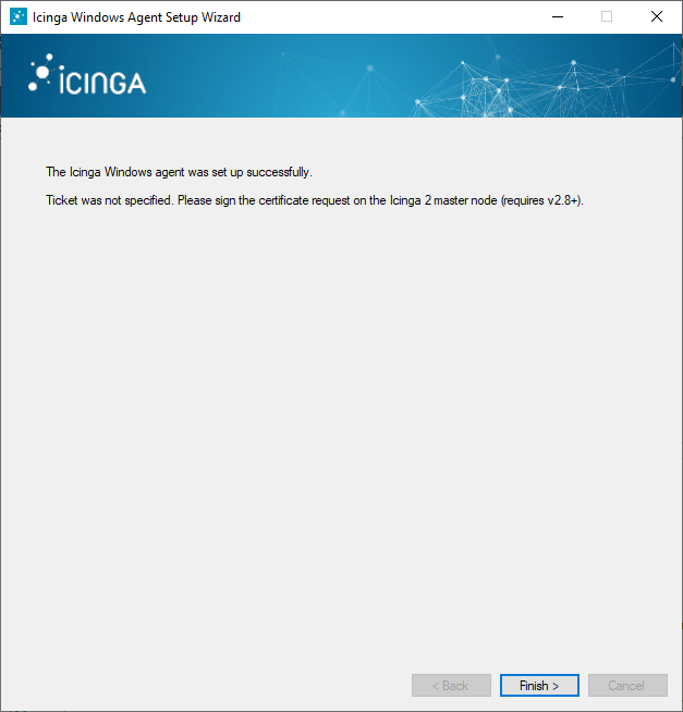

Proceed with adding the optional client ticket for CSR auto-signing:
Please specify the request ticket generated on your Icinga 2 master (optional).
 (Hint: # icinga2 pki ticket --cn 'icinga2-agent1.localdomain'):
4f75d2ecd253575fe9180938ebff7cbca262f96e
In case you’ve chosen to use On-Demand CSR Signing you can leave the ticket question blank.
Instead, Icinga 2 tells you to approve the request later on the master node.
No ticket was specified. Please approve the certificate signing request manually
on the master (see 'icinga2 ca list' and 'icinga2 ca sign --help' for details).

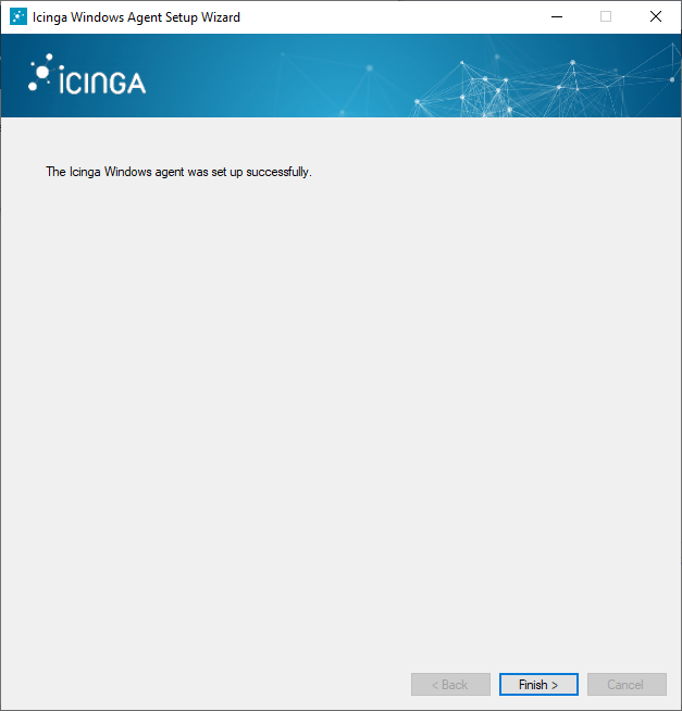

Agent Setup on Windows: Installer
Download the MSI-Installer package from https://packages.icinga.com/windows/. The preferred flavor is x86_64 for modern Windows systems.
The Windows package provides native monitoring plugin binaries to get you started more easily. The installer package also includes the NSClient++ package to allow using its built-in plugins. You can find more details in this chapter.
Note
Please note that Icinga 2 was designed to run as light-weight agent on Windows. There is no support for satellite instances.
Run the MSI-Installer package and follow the instructions shown in the screenshots.
Icinga 2 Windows Setup Icinga 2 Windows Setup Icinga 2 Windows Setup Icinga 2 Windows Setup Icinga 2 Windows Setup
The graphical installer offers to run the Icinga Agent setup wizard after the installation. Select the check box to proceed.
Tip
You can also run the Icinga agent setup wizard from the Start menu later.
Agent Setup on Windows: Configuration Wizard
On a fresh installation the setup wizard guides you through the initial configuration. It also provides a mechanism to send a certificate request to the CSR signing master.
The following configuration details are required:
Parameter Description
Instance name Required. By convention this should be the host’s FQDN. Defaults to the FQDN.
Setup ticket Optional. Paste the previously generated ticket number. If left blank, the certificate request must be signed on the master node.
Fill in the required information and click Add to add a new master connection.

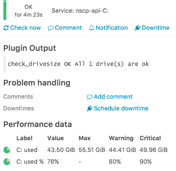

The NSClient++ REST API can be used to query metrics. check_nscp_api uses this transport method.
Finish Windows Agent Setup
Finish the Windows setup wizard.
If you did not provide a setup ticket, you need to sign the certificate request on the master. The setup wizards tells you to do so. The Icinga 2 service is running at this point already and will automatically receive and update a signed client certificate.

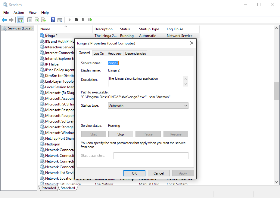

Now you need to restart the Icinga 2 service. Run services.msc from the start menu and restart the icinga2 service. Alternatively open an administrative Powershell and run the following commands:
C:\> Restart-Service icinga2
C:\> Get-Service icinga2

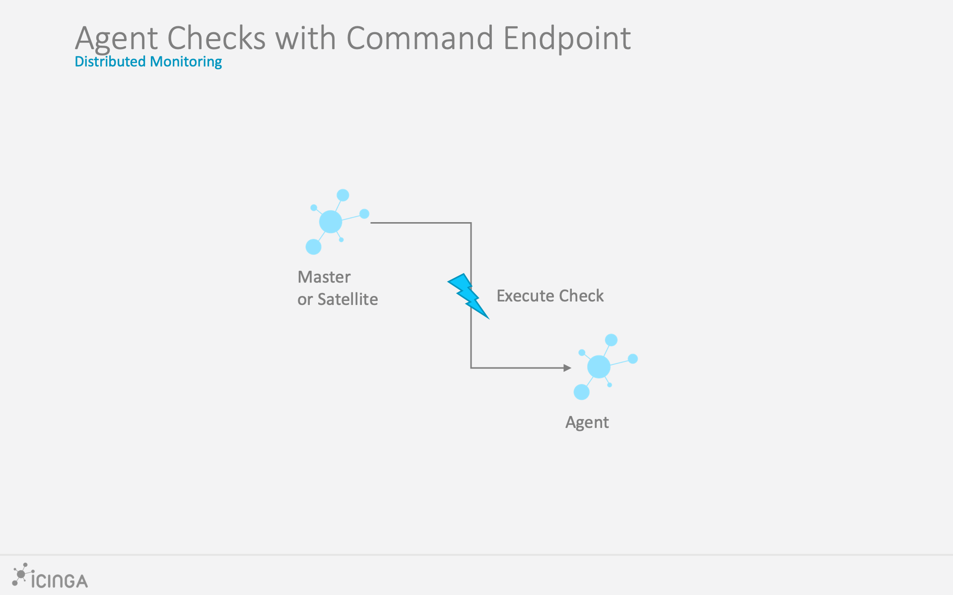

Top Down Command Endpoint
This mode forces the Icinga 2 node to execute commands remotely on a specified endpoint. The host/service object configuration is located on the master/satellite and the agent only needs the CheckCommand object definitions available.
Every endpoint has its own remote check queue. The amount of checks executed simultaneously can be limited on the endpoint with the MaxConcurrentChecks constant defined in constants.conf. Icinga 2 may discard check requests, if the remote check queue is full.
Icinga 2 Distributed Top Down Command Endpoint

Master with Agents
In this scenario, a single master node runs the check scheduler, notifications and IDO database backend and uses the command endpoint mode to execute checks on the remote agents.
Icinga 2 Distributed Master with Agents
  • icinga2-master1.localdomain is the primary master node.
  • icinga2-agent1.localdomain and icinga2-agent2.localdomain are two child nodes as agents.
Setup requirements:
  • Set up icinga2-master1.localdomain as master.
  • Set up icinga2-agent1.localdomain and icinga2-agent2.localdomain as agent.
Edit the zones.conf configuration file on the master:
[root@icinga2-master1.localdomain /]# vim /etc/icinga2/zones.conf
object Endpoint "icinga2-master1.localdomain" {
  // That's us
object Endpoint "icinga2-agent1.localdomain" {
  host = "192.168.56.111" // The master actively tries to connect to the agent
  log_duration = 0 // Disable the replay log for command endpoint agents
object Endpoint "icinga2-agent2.localdomain" {
  host = "192.168.56.112" // The master actively tries to connect to the agent
object Zone "master" {
  endpoints = [ "icinga2-master1.localdomain" ]
object Zone "icinga2-agent1.localdomain" {
  endpoints = [ "icinga2-agent1.localdomain" ]
  parent = "master"
object Zone "icinga2-agent2.localdomain" {
  endpoints = [ "icinga2-agent2.localdomain" ]
  parent = "master"
/* sync global commands */
  global = true
  global = true
The two agent nodes do not need to know about each other. The only important thing is that they know about the parent zone and their endpoint members (and optionally the global zone).
If you specify the host attribute in the icinga2-master1.localdomain endpoint object, the agent will actively try to connect to the master node. Since you’ve specified the agent endpoint’s attribute on the master node already, you don’t want the agents to connect to the master. Choose one connection direction.

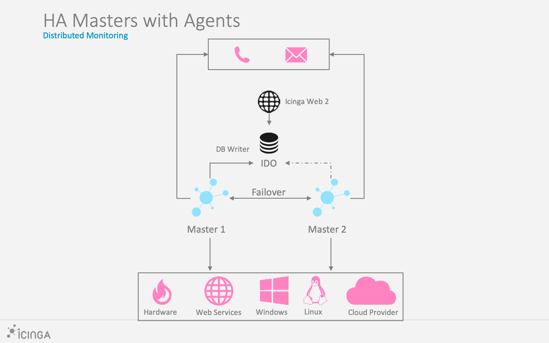

High-Availability Master with Agents
This scenario is similar to the one in the previous section. The only difference is that we will now set up two master nodes in a high-availability setup. These nodes must be configured as zone and endpoints objects.
Icinga 2 Distributed High Availability Master with Agents
The setup uses the capabilities of the Icinga 2 cluster. All zone members replicate cluster events between each other. In addition to that, several Icinga 2 features can enable HA functionality.
Best practice is to run the database backend on a dedicated server/cluster and only expose a virtual IP address to Icinga and the IDO feature. By default, only one endpoint will actively write to the backend then. Typical setups for MySQL clusters involve Master-Master-Replication (Master-Slave-Replication in both directions) or Galera, more tips can be found on our community forums. The IDO object must have the same instance_name on all master nodes.
Note: All nodes in the same zone require that you enable the same features for high-availability (HA).
Overview:
  • icinga2-master1.localdomain is the config master master node.
  • icinga2-master2.localdomain is the secondary master master node without config in zones.d.
Setup requirements:
  • Set up icinga2-master2.localdomain as satellite (we will modify the generated configuration).
  • Set up icinga2-agent1.localdomain and icinga2-agent2.localdomain as agents (when asked for adding multiple masters, set to y and add the secondary master icinga2-master2.localdomain).
In case you don’t want to use the CLI commands, you can also manually create and sync the required TLS certificates. We will modify and discuss all the details of the automatically generated configuration here.
Since there are now two nodes in the same zone, we must consider the high-availability features.
  • Checks and notifications are balanced between the two master nodes. That’s fine, but it requires check plugins and notification scripts to exist on both nodes.
  • The IDO feature will only be active on one node by default. Since all events are replicated between both nodes, it is easier to just have one central database.
One possibility is to use a dedicated MySQL cluster VIP (external application cluster) and leave the IDO feature with enabled HA capabilities. Alternatively, you can disable the HA feature and write to a local database on each node. Both methods require that you configure Icinga Web 2 accordingly (monitoring backend, IDO database, used transports, etc.).
Note
You can also start with a single master shown here and later add the second master. This requires an extra step with the initial sync for cloning the runtime state after done. Once done, proceed here.

The specified parent nodes will forward the CSR signing request to the master instances.

Since we want to use top down command endpoint checks, we must configure the agent endpoint and zone objects.
In order to minimize the effort, we’ll sync the agent zone and endpoint configuration to the satellites where the connection information is needed as well. Note: This only works with satellite and agents, since there already is a trust relationship between the master and the satellite zone. The cluster config sync to the satellite invokes an automated reload causing the agent connection attempts.

Next, add the disk check using command endpoint checks (details in the disk-windows documentation):
[root@icinga2-master1.localdomain /etc/icinga2/zones.d/master]# vim services.conf
apply Service "disk C:" {
  check_command = "disk-windows"
  vars.disk_win_path = "C:"
  //specify where the check is executed
  command_endpoint = host.vars.agent_endpoint
  assign where host.vars.os_type == "windows" && host.vars.agent_endpoint
Validate the configuration and restart Icinga 2.
[root@icinga2-master1.localdomain /]# icinga2 daemon -C
[root@icinga2-master1.localdomain /]# systemctl restart icinga2
Open Icinga Web 2 and check your newly added Windows disk check :)

The service checks are generated using an apply for rule based on host.vars.drives:
apply Service "nscp-api-" for (drive in host.vars.drives) {
  import "generic-service"
  check_command = "nscp_api"
  //display_name = "nscp-drive-" + drive
  vars.nscp_api_host = "localhost"
  vars.nscp_api_query = "check_drivesize"
  vars.nscp_api_password = host.vars.nscp_api_password
  vars.nscp_api_arguments = [ "drive=" +  drive ]
  ignore where host.vars.os_type != "Windows"
Two new services (“nscp-drive-D:” and “nscp-drive-C:”) will be visible in Icinga Web 2.
Icinga 2 Distributed Monitoring Windows Agent with NSClient++ nscp-api
Note: You can also omit the command_endpoint configuration to execute the command on the master. This also requires a different value for nscp_api_host which defaults to host.address.

High-Availability for Icinga 2 Features
By default, the following features provide advanced HA functionality:
High-Availability with Checks
All instances within the same zone (e.g. the master zone as HA cluster) must have the checker feature enabled.
Example:
icinga2 feature enable checker
All nodes in the same zone load-balance the check execution. If one instance shuts down, the other nodes will automatically take over the remaining checks.
High-Availability with Notifications
All instances within the same zone (e.g. the master zone as HA cluster) must have the notification feature enabled.
Example:
icinga2 feature enable notification
Notifications are load-balanced amongst all nodes in a zone. By default this functionality is enabled. If your nodes should send out notifications independently from any other nodes (this will cause duplicated notifications if not properly handled!), you can set enable_ha = false in the NotificationComponent feature.
High-Availability with DB IDO
All instances within the same zone (e.g. the master zone as HA cluster) must have the DB IDO feature enabled.
Example DB IDO MySQL:
icinga2 feature enable ido-mysql
By default the DB IDO feature only runs on one node. All other nodes in the same zone disable the active IDO database connection at runtime. The node with the active DB IDO connection is not necessarily the zone master.
Note: The DB IDO HA feature can be disabled by setting the enable_ha attribute to false for the IdoMysqlConnection or IdoPgsqlConnection object on all nodes in the same zone.
All endpoints will enable the DB IDO feature and connect to the configured database and dump configuration, status and historical data on their own.
If the instance with the active DB IDO connection dies, the HA functionality will automatically elect a new DB IDO master.
The DB IDO feature will try to determine which cluster endpoint is currently writing to the database and bail out if another endpoint is active. You can manually verify that by running the following query command:
icinga=> SELECT status_update_time, endpoint_name FROM icinga_programstatus;
   status_update_time   | endpoint_name
 2016-08-15 15:52:26+02 | icinga2-master1.localdomain
(1 Zeile)
This is useful when the cluster connection between endpoints breaks, and prevents data duplication in split-brain-scenarios. The failover timeout can be set for the failover_timeout attribute, but not lower than 60 seconds.

Disable Log Duration for Command Endpoints
The replay log is a built-in mechanism to ensure that nodes in a distributed setup keep the same history (check results, notifications, etc.) when nodes are temporarily disconnected and then reconnect.
This functionality is not needed when a master/satellite node is sending check execution events to an agent which is configured as command endpoint for check execution.
The Endpoint object attribute log_duration can be lower or set to 0 to fully disable any log replay updates when the agent is not connected.

Silent Windows Setup
If you want to install the agent silently/unattended, use the /qn modifier. The installation should not trigger a restart, but if you want to be completely sure, you can use the /norestart modifier.
C:> msiexec /i C:\Icinga2-v2.5.0-x86.msi /qn /norestart
Once the setup is completed you can use the node setup cli command too.

In case you did not provide a ticket, you need to manually sign the CSR on the master node which holds the CA’s key pair.
