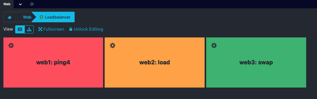

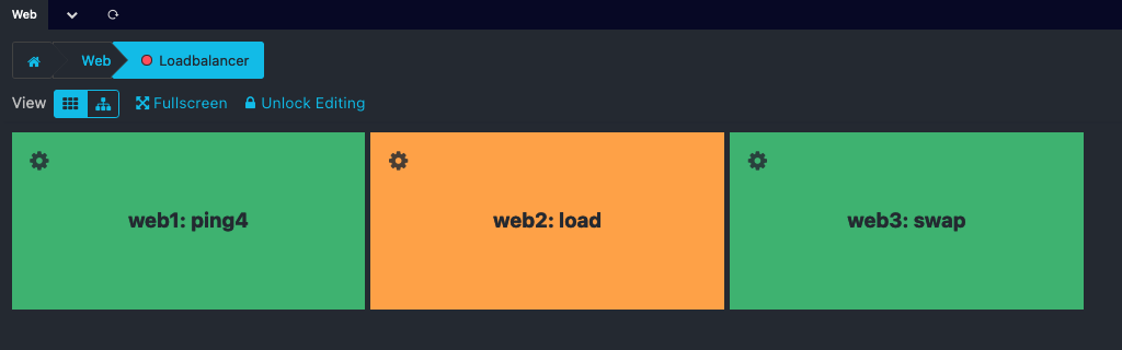

OR
The OR operator selects the BEST state of its child nodes:
Or Operator
Or Operator #2
