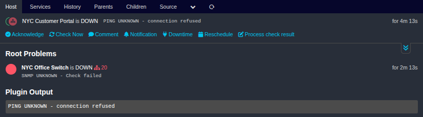

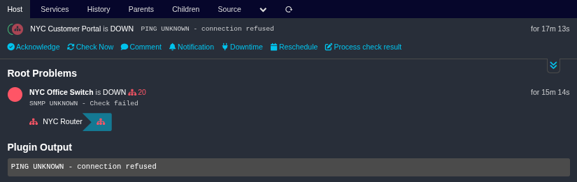

This can be extended further. Imagine a group of servers relying on the router. Now, the dependency chain spans three levels: servers depend on the router, and the router depends on the switch. If the switch goes down, it renders both the router and the servers unreachable. To help identify the core issue, Icinga displays the root cause—here, the switch—at the top of each affected object’s detail view, regardless of how deep the dependency goes.
Root Problem
Root Problem
Below is the path leading to the root problem, relative to the current child.

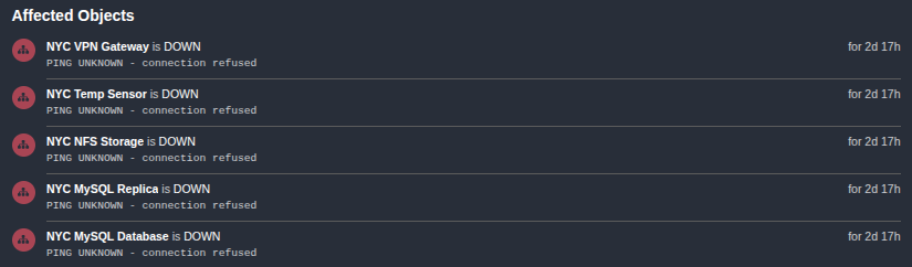

Users can click on the root problem to open its detail view, where the most critically affected child objects are shown prominently. This helps in quickly gauging the overall impact. Additionally, related parent and child objects are organized in separate tabs for better clarity—especially useful in environments with many interconnected systems.
Affected Children

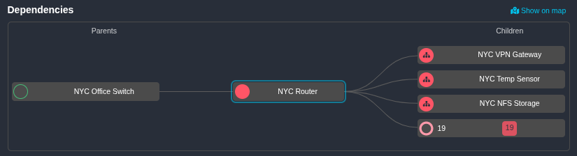

Dependencies Widget
This component visualizes the current location in the dependency hierarchy with context about the nearest parents and children.

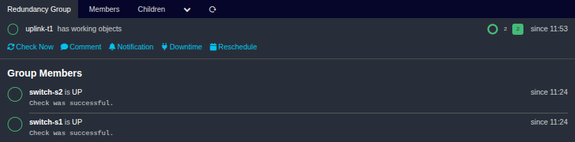

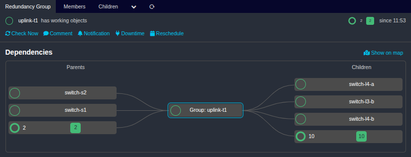

A brief mention should also be made of redundancy groups. While not everyone may be familiar with them, they share similarities with Icinga Business Process Modeling using the OR operator. Redundancy groups allow the expression of high availability setups within the dependency structure. As long as one member is functioning properly, the group is considered healthy. If all members fail, their dependent objects are marked as unreachable.
