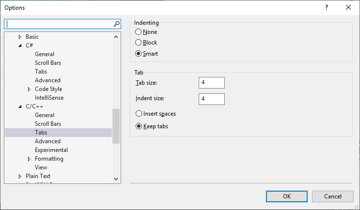

Tabs instead of spaces. Inside Visual Studio, choose to keep tabs instead of spaces. Tabs should use 4 spaces indent by default, depending on your likings.

Whitespace Cleanup ¶
Patches must be cleaned up and follow the indent style (tabs instead of spaces). You should also remove any trailing whitespaces.
git diff allows to highlight such.

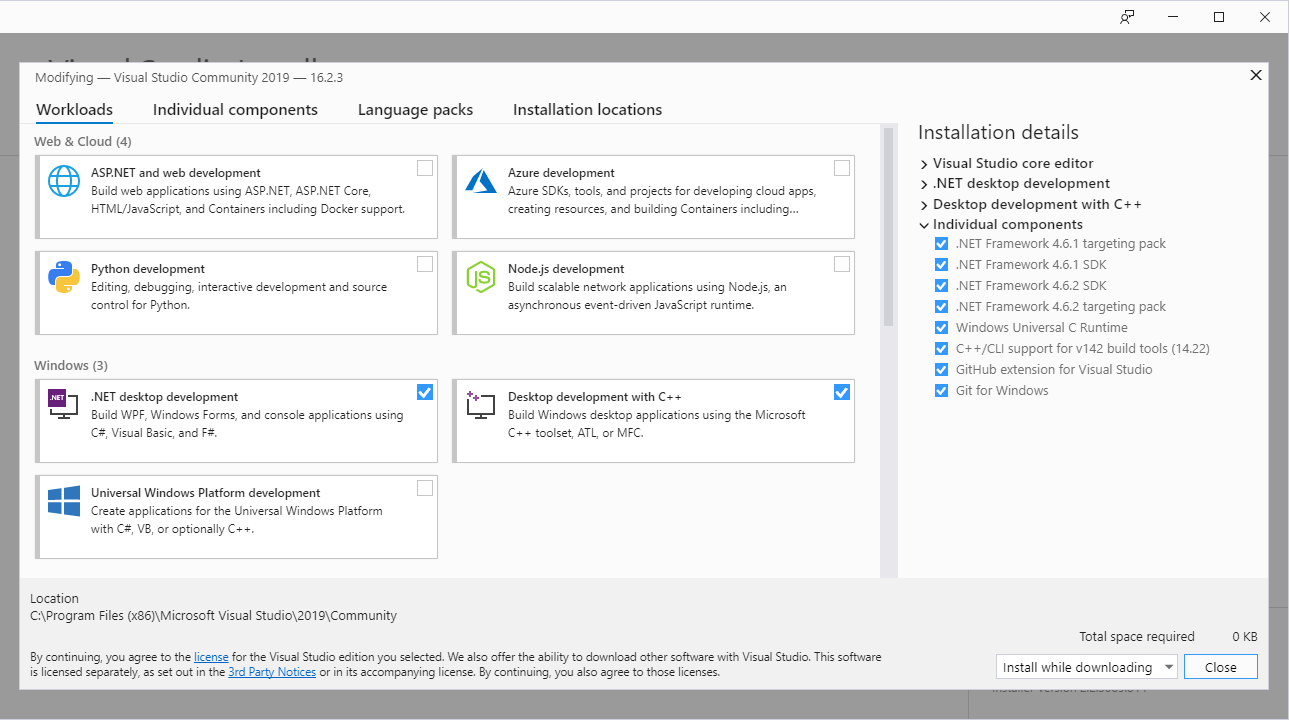

Visual Studio¶
Thanks to Microsoft they’ll now provide their Professional Edition of Visual Studio as community version, free for use for open source projects such as Icinga. The installation requires ~9GB disk space. Download the web installer and start the installation.
Note: Only Visual Studio 2019 is covered here. Older versions are not supported.
You need a free Microsoft account to download and also store your preferences.
Install the following complete workloads:
- C++ Desktop Development
- .NET Desktop Development
In addition also choose these individual components on Visual Studio:
- .NET
- .NET Framework 4.x targeting packs
- .NET Framework 4.x.y SDKs
- Code tools
- Git for Windows
- GitHub Extension for Visual Studio
- NuGet package manager
- Compilers, build tools and runtimes
- C# and Visual Basic Roslyn compilers
- C++ 2019 Redistributable Update
- C++ CMake tools for Windows
- C++/CLI Support for v142 build tools (14.22)
- MSBuild
- MSVC v142 - VS 2019 C++ x64/x86 build tools (v14.22)
- Debugging and testing
- .NET profiling tools
- C++ profiling tools
- Just-in-Time debugger
- Development activities
- C++ core features
- IntelliCode
- Live Share
- Games and Graphics
- Graphics debugger and GPU profiler for DirectX (required by C++ profiling tools)
- SDKs, libraries and frameworks
- Windows 10 SDK (10.0.18362.0 or later)
- Windows Universal C Runtime
After a while, Visual Studio will be ready.
Style Guide for Visual Studio¶
Navigate into Tools > Options > Text Editor and repeat the following for
- C++
- C#
Navigate into Tabs and set:
- Indenting: Smart (default)
- Tab size: 4
- Indent size: 4
- Keep tabs (instead of spaces)

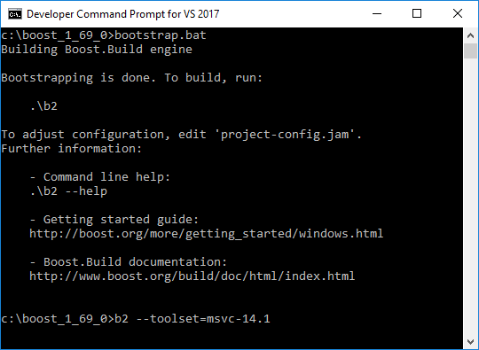

In order to integrate Boost into Visual Studio, open the Developer Command Prompt from the start menu,
and navigate to C:\local\boost_1_85_0.
Execute bootstrap.bat first.
cd C:\local\boost_1_85_0
bootstrap.bat
Once finished, specify the required toolset to compile boost against Visual Studio.
This takes quite some time in a Windows VM. Boost Context uses Assembler code,
which isn’t treated as exception safe by the VS compiler. Therefore set the
additional compilation flag according to this entry.
b2 --toolset=msvc-14.2 link=static threading=multi runtime-link=static address-model=64 asmflags=\safeseh

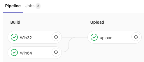

Windows Builds ¶
The Windows MSI packages are located at https://packages.icinga.com/windows/
The build infrastructure is based on GitLab CI and an Ansible provisioned Windows VM running in OpenStack.
The runner uses the scripts located in tools/win32 to configure, build
and test the packages. Uploading them to the package repository is a
separate step. For manual package creation, please refer to this chapter.
