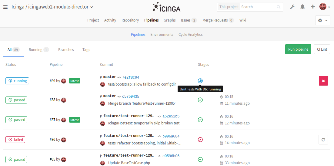

Tests on Travis-CI
When pushing to GitHub or sending pull requests, Unit-Tests are automatically triggered on Travis-CI:
Build Status
We run our tests against MySQL and PostgreSQL, with PHP versions ranging from 5.3 to 7.1, including nightly builds.

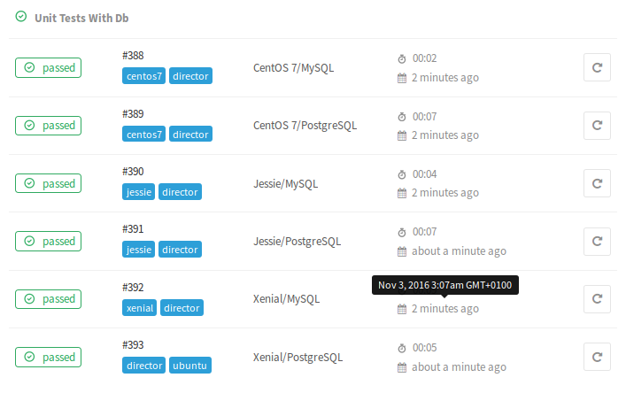

Tests for supported Platforms
As far as we know, Director is currently mostly used on CentOS (or RHEL) versions 6 and 7, Debian Stable (Jessie) and Ubuntu LTS (Xenial). So we are running our tests on our own platforms for exactly those systems. All of them with PostgreSQL, MySQL (or MariaDB).
This way we reach the mostly used Database and PHP versions:
Test result

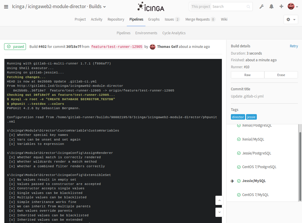

The very same output could look as follows when shown by your CI-Tool:
Test result - testdox
Running with Gitlab-CI
