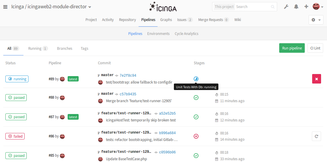

Tests on Travis-CI¶
When pushing to GitHub or sending pull requests, Unit-Tests are automatically triggered on Travis-CI:
We run our tests against MySQL and PostgreSQL, with PHP versions ranging from 5.3 to 7.1, including nightly builds.

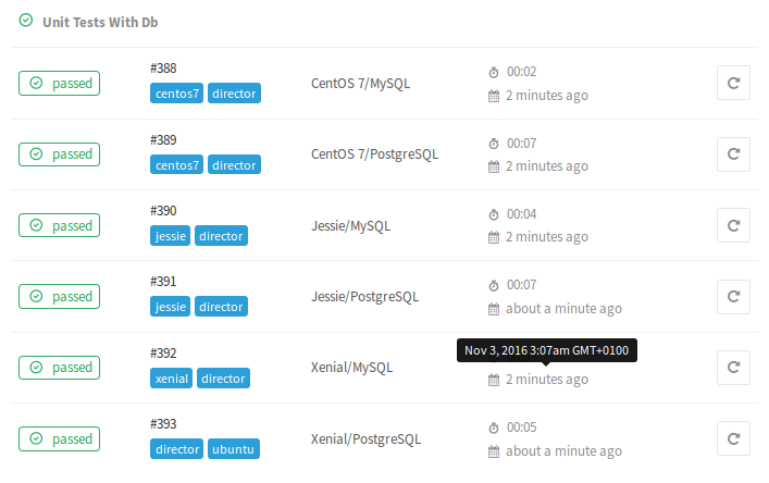

Tests for supported Platforms¶
As far as we know, Director is currently mostly used on CentOS (or RHEL) versions 6 and 7, Debian Stable (Jessie) and Ubuntu LTS (Xenial). So we are running our tests on our own platforms for exactly those systems. All of them with PostgreSQL, MySQL (or MariaDB).
This way we reach the mostly used Database and PHP versions:

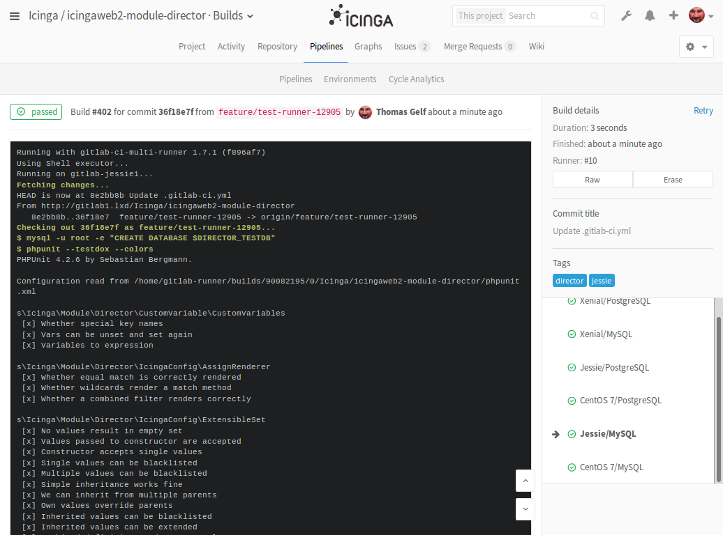

…or this:
PHPUnit 5.1.3 by Sebastian Bergmann and contributors.
s\Icinga\Module\Director\CustomVariable\CustomVariables
[x] Whether special key names
[x] Vars can be unset and set again
[x] Variables to expression
s\Icinga\Module\Director\IcingaConfig\AssignRenderer
[x] Whether equal match is correctly rendered
[x] Whether wildcards render a match method
[x] Whether a combined filter renders correctly
s\Icinga\Module\Director\IcingaConfig\ExtensibleSet
[x] No values result in empty set
[x] Values passed to constructor are accepted
[x] Constructor accepts single values
[x] Single values can be blacklisted
[x] Multiple values can be blacklisted
[x] Simple inheritance works fine
[x] We can inherit from multiple parents
[x] Own values override parents
[x] Inherited values can be blacklisted
[x] Inherited values can be extended
[x] Combined definition renders correctly
s\Icinga\Module\Director\IcingaConfig\IcingaConfigHelper
[x] Whether interval string is correctly parsed
[x] Whether invalid interval string raises exception
[x] Whether an empty value gives null
[x] Whether interval string is correctly rendered
[x] Correctly identifies reserved words
The very same output could look as follows when shown by your CI-Tool:
Running with Gitlab-CI¶
This chapter assumes that you have Gitlab and Gitlab-CI up and running. Our
gitlab-ci.yml file currently supposes you to have shared runners providing
specific tags and the following operating systems, each of them with MySQL and
PostgreSQL installed locally:
- CentOS 7
- Debian Stable (Jessie)
- Ubuntu 16.04 LTS (Xenial)
