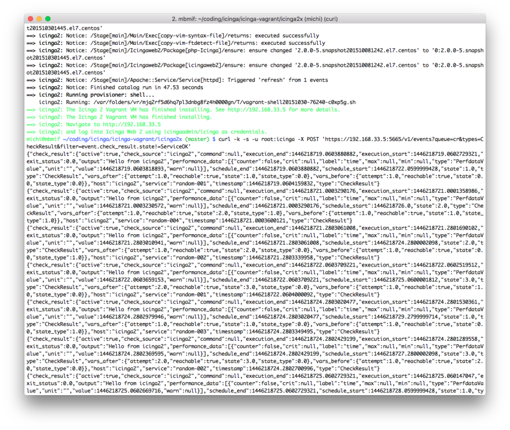

Send a POST request to /v1/events and pass the following as URL parameter:
  • queue name
  • types (one or more event types, e.g. CheckResult, Notification, etc)
  • filter (match on event. attributes)
More details can be found in the snapshot documentation. Ready to test-drive the API? The Vagrant boxes are running the latest snapshots allowing to easily connect to the REST API – check the screencast 🙂
$ git clone https://github.com/Icinga/icinga-vagrant.git && cd icinga-vagrant
$ cd icinga2x
$ vagrant up
$ curl -k -s -u root:icinga -H 'Accept: application/json' -X POST 'https://192.168.33.5:5665/v1/events?queue=more&types=CheckResult&types=Notification&types=DowntimeTriggered'
$ curl -k -s -u root:icinga -H 'Accept: application/json' -X POST 'https://192.168.33.5:5665/v1/events?queue=cr&types=CheckResult&filter=event.check_result.state!=ServiceOK'

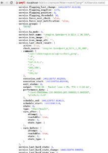

Status Queries
While Livestatus and DB IDO do not expose all object attributes, the Icinga 2 API allows you to fetch all object types and their runtime configuration and state attributes. Apart from accessing a single object you may also use the same filter expressions known from apply rules to fetch a filtered list of objects.
You can select specific attributes by adding them as url parameters using ?attrs=…. Multiple attributes must be added one by one, e.g. ?attrs=host.address&attrs=host.name.
$ curl -u root:icinga -k -s 'https://localhost:5665/v1/objects/hosts/google.com?attrs=host.name&attrs=host.address' -X GET | python -m json.tool
    "results": [
            "attrs": {
                "host.address": "8.8.8.8",
                "host.name": "google.com"
Another cool thing – the check results also contain the executed command. That’s something pretty helpful for testing your configuration. Or – check the group membership of a host. Modify the attributes at runtime, and retrieve their status again.
icinga2_api_status_query_host_01 icinga2_api_status_query_host_02 icinga2_api_status_query_service_checkresult
Hint: If you want to view JSON in your browser, look for apps like for Chrome: JsonView.

Event Streams
Register clients listening on event streams and filter these events, e.g. only receive not-ok states. The following example is from our concept phase to give you an idea:
Request:
$ curl -k -s -u root:icinga -X POST 'https://localhost:5665/v1/events?queue=michi&types=CheckResult&filter=event.check_result.exit_status==2'
{"check_result":{ ... },"host":"www.icinga.org","service":"ping4","timestamp":1445421319.7226390839,"type":"CheckResult"}
{"check_result":{ ... },"host":"www.icinga.org","service":"ping4","timestamp":1445421324.7226390839,"type":"CheckResult"}
{"check_result":{ ... },"host":"www.icinga.org","service":"ping4","timestamp":1445421329.7226390839,"type":"CheckResult"}
Note: This is not implemented yet. Development sprint is scheduled for CW42.
Btw – ohcp and oscp commands should be fairly replaceable by event stream clients forwarding all events to your umbrella monitoring system.

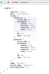

Reflection
List all url endpoints (objects, types, attributes) including details. Take an example: The Icinga 2 types follow an hierarchical order: Host inherits from Checkable inherits from  CustomVarObject inherits from ConfigObject inherits from Object. Using that information including all the object attributes you’ll get:
  • all object attributes
  • all object type prototypes (e.g. Object#clone)
icinga2_api_reflection_type_host icinga2_api_reflection_type_dictionary icinga2_api_reflection_type_apiuser

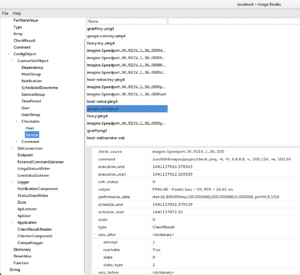

(HTTP) Clients
Ok, there’s curl and alternatives on the shell. We’ll also work on the icinga2 console providing an HTTP client to directly connect to the Icinga 2 API.
But yet there’s another cool thing: Icinga Studio. It connects to the Icinga 2 API and provides a type hierarchy including all objects and their runtime configuration and state. Built with wxWidgets making it cross-plattform (Linux, Windows, MacOSX). We’ll prepare packages in the next weeks for that as well (only where wxWidgets is available). For now it helps debugging and testing, at some later point we may consider changing its read-only state allowing runtime modifications 🙂
icinga2_api_icinga_studio_01 icinga2_api_icinga_studio_02 icinga2_api_icinga_studio_03
